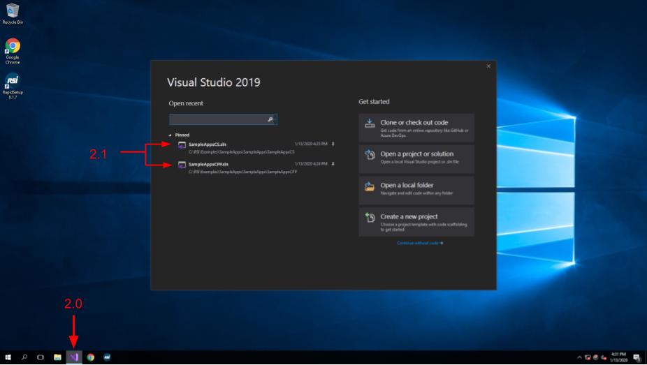

2.0 Start Visual Studio
2.1 Open the C# or C++ Sample Application Solution

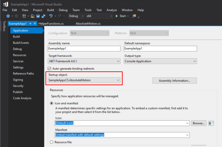

3.1 Right click the Solution in the Solution Explorer and select Properties.
3.2 Select the desired Sample app from the drop down menu.
3.3 Start the application.

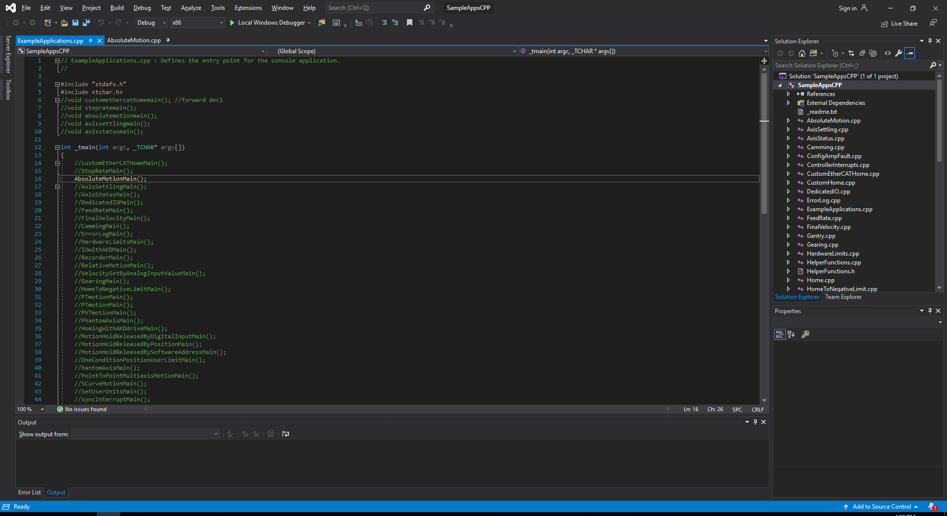

3.1 Un-comment the Sample application you would like to run
3.2 Start the application.
