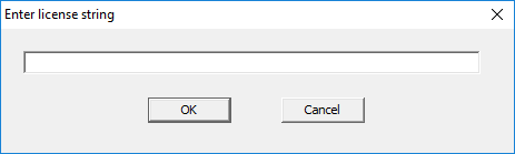

      Included in the USB hardware key package, there should be a card with a 30 digit license code (License code for this USB Key:).
    3. 3.
      Click the “Enter String” button.
    4. 4.
      Enter the 30 digit code (with or without dashes) into the box and click OK.
    3. 3.
    4. 4.
